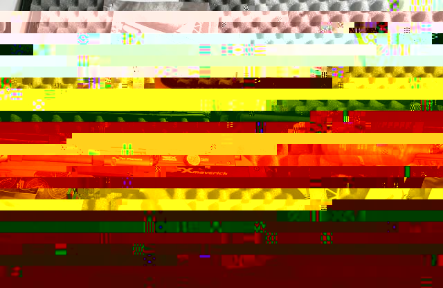

Saber Tactical ma v nabidce novou listu vhodnou pro Maverick,DreamTac a Impact,uchyceni pro picatinny,arca swiss a m-lok
https://ibb.co/zNtVzHF
